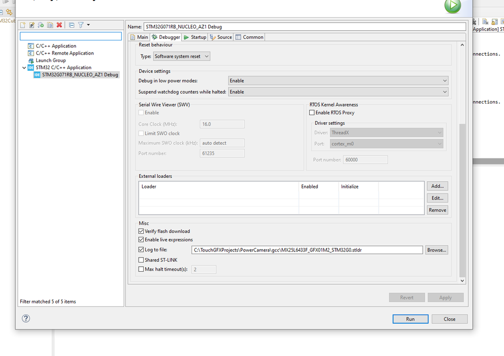

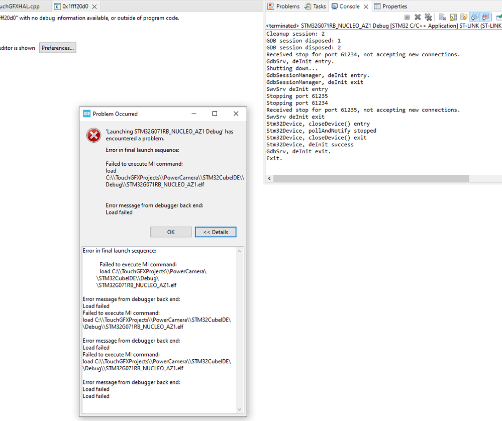

I start to work with touchgfx 4.21.1 and i create my first program. I use (is the first time) STM32CubeIde i compile the program and everythingh work but when i try to download to my nucleo borard i receive this error message . I searc in internet i try a lot of stuff but without success . Please some one can help me ?

In your debug configuration you selected your stldr file in "Log to file" which is not the right place, as this is meant for a txt file which will receive the debug log. Actually it might have corrupted your file so I suggest you create a new touchgfx project which will generate a new stldr file. Then copy the file to ...\STM32CubeIDE\plugins\com.st.stm32cube.ide.mcu.externaltools.cubeprogrammer.win32_2.0.301.202207041506\tools\bin\ExternalLoader
Afterwards, it should be listed in the External loaders panel in debug config. If not, add it.

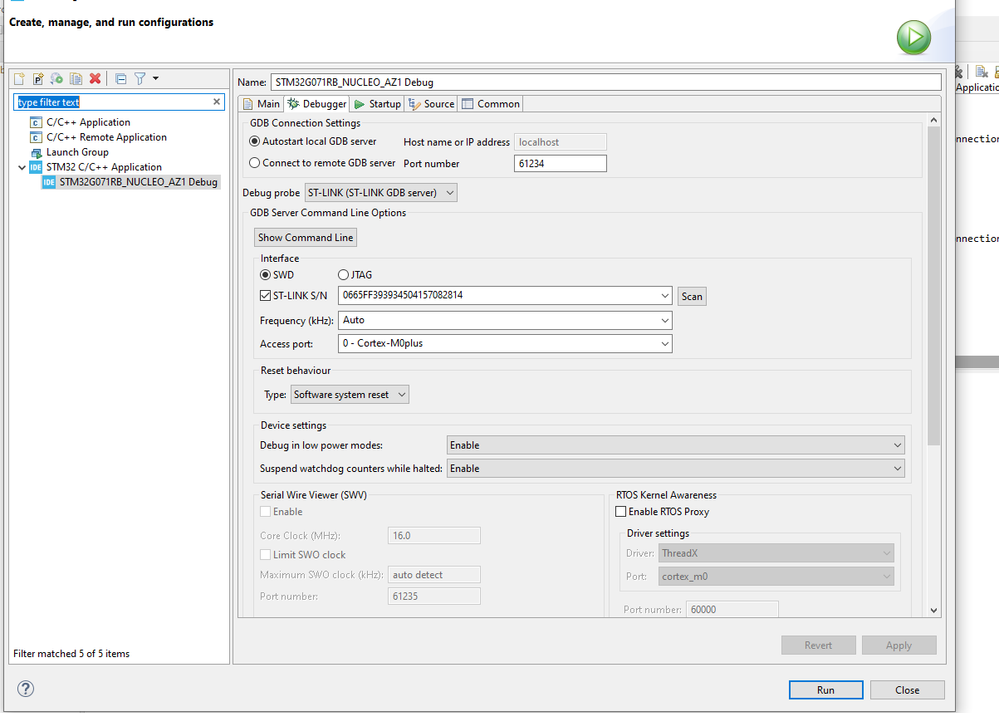

first for the replace, i follow the tutorial but still have the same problem. the version of STM32cubeide is 1.12, i put the file inside this folder
any idea ?
Thanks a lot
Sergio
2023-03-13 8:59 PM
Just to make sure did you add the file to the highlighted folder or to the tools\bin\ExternalLoader of it :grinning_face_with_sweat:It is surprising that you have 2 externaltools.cubeprogrammer folder as well. On my side, for STM32CubeIDE_1.12 I only have the second one ( the 0.600.202301161003). maybe try this one ? And then setting the correct external loader in the Debug settings.
