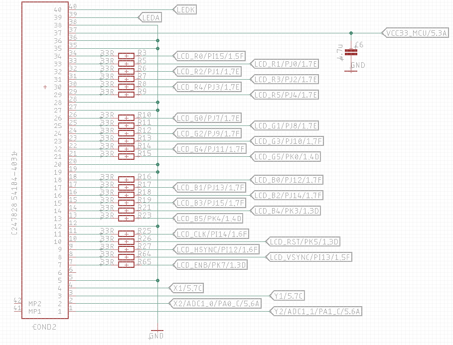

Hello everyone, I have a big problem with the hardware. I designed the hardware before dealing with the Cubemx. Starting from a circuit that worked, I mistakenly thought that giving the system RGB666 from RGB888 meant giving bits 0 to 6 R0...R6, G0..G6, B0..B6. I then connected the two bits of the display R0, R1, G0, G1, B0 B1 to ground, as shown in the figure. But I have the problem that everything is wrong.Is it possible to remap LTDC so I can see everything properly?
Thanks for your help.

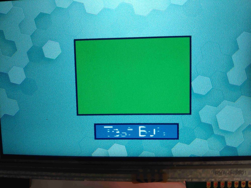

MM..1, YOU SAVED ME! how this mechanism work? different bit/byte distribution? I'm a newbie on interfaces, I'm 12 years old on power systems... very distant from this field. Really thanks!
2023-09-10 5:22 AM
But now I have this proble, this is for L8? I don't understand...
