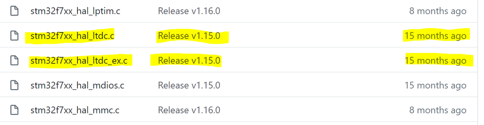

No changes to stm32f7xx_hal_ltdc*.{c,h} from v1.15.0 to v1.16.0:
You should be able to update the IDE independently from the HAL package. I would do that to narrow down the source of the problem. Start with something that works, change one thing at a time.
CubeIDE latest version is v1.4.2. No reason not to update to the latest version if you're going to update at all, IMO.
