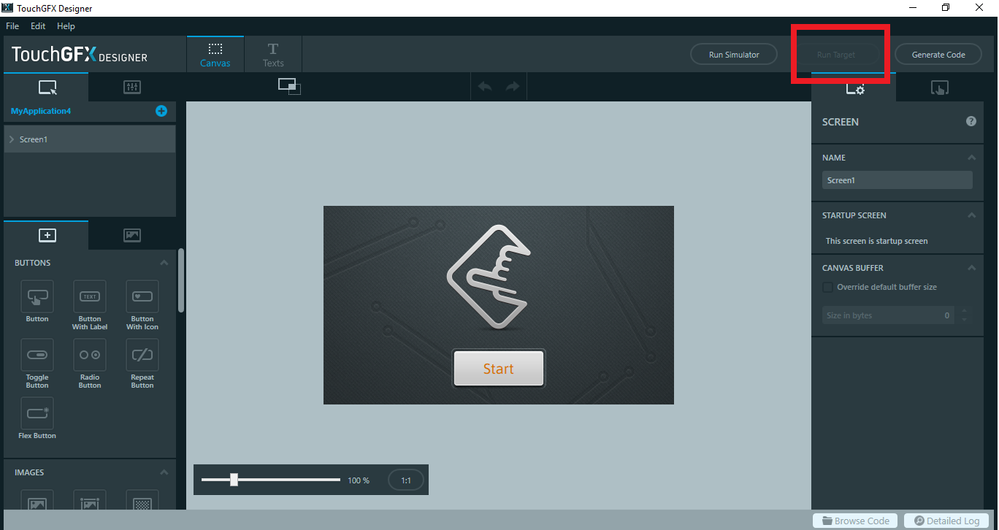

I have installed the last version of TouchGFX Designer.
I choose the board STM32-F429ZI and an example.
I may simulate the example in the computer and it work correctly. But, even though I have connected the board to computer, the button "Run Target" is unavailable.
I also have STMCubeMX installed, but I do not believe that it can affect TouchGFX Designer.

Although I select "Generate Code", the button "Run Target" is unavailable.
