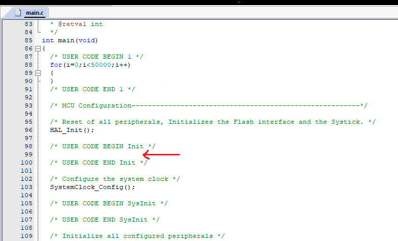

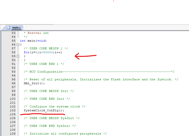

I can share a turn around until someone suggests a proper solution.
The root cause is that if the power doesn't rise as sharply, SystemClock_Config(); won't be able to initialize clocks and hence program won't run until reset manually.
So I gave a small delay before SystemClock_Config(); and now code executes automatically even when i connect to external power source.
2023-02-08 2:09 PM
Regardless of the fact that fakes of the STM32F103 are usually equipped with so-called Blue Pill boards, the behaviour of which varies greatly depending on the counterfeiter: a loop like this
for(i=0;i<50000;i++){}will normally disappear without a trace during optimisation because it does not perform any meaningful action. One used something like this as a time loop in the early years of MCUs, but this is very quickly recognised by the optimisation functions of the C compilers and rightly removed - if one does not deactivate or limit them.
