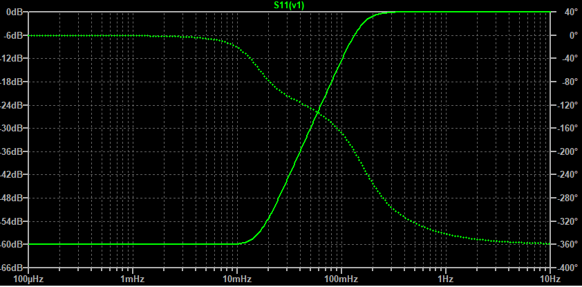

I'm working on an GUI that has mainly a static graph wich plots bode diagrams. So i have been searching on the API of touch gfx ways to make a logspace in x-axis in order to plot frequency but a i didnt find a way to change the linear magnitude of x-axis.I would need something like this:
Is it possible to manipulate x-axis scale?

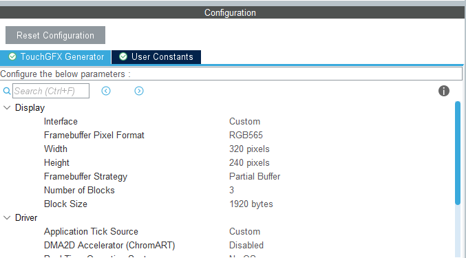

Hello Again, i managed to make a log scale graph adding lines. It works fine. However, i have done a logic to switch between two graphs that already have their points loaded on the widget, and the refresh of the screen is very slow, it takes about 3 seconds to set one graph visible and the other not visible. It's a problem of the widget or my MCU?. I'm using NUCLEO f401RE with 84MHz of clock and 30uS of refresh of the engine. Also im using the partial frame buffer strategy. Here is the logic code for switching graphs:

I suppose your graphs take almost the full screen ? If yes then I am not surprised that it would take some time to disappear and be replaced by another. With the partial framebuffer strategy you only update blocks of the screens at a time, so full screen animations can take some time and also show some tearing effects. To speed up your process you can either change the framebuffer strategy or try to play around what you refresh on your display. You need to reduce the size and the amount of things you update at the same time. In the simulator I recommend to use the different features available, like "F2" to show what zones are updated, "F9" to pause the simulator and "F10" to go one tick at the time so that you can see exactly what zones of the display are being refreshed when you go from a graph to another.
Are you working with a dynamic graph or a static graph ? Something you could do with a dynamic graph for example would be to reach the end of the graph and then "clean" the graph (get rid of all the points), switch to the other graph and then display one by one the values of the new graph. Not sure if I am clear or not but what I am trying to say is that I would rather have an animation of the new graph filling up itself point by point rather than just making it appear with all the points already set as this means a full screen update. This still implies a "long" transition (wont take 3s but need to be tested) but at least it will look smooth instead of a freezy/laggy transition.

When you press the button in your project to go from a graph to another you can see by pressing F2 on the simulator that the entire screen is being refreshed. You need to avoid that because you are working with the partial framebuffer strategy, meaning that you can only update some small sections of the display at the time and not everything at once. The idea behind cleaning what is currently displayed before doing the graph swap is to reduce the size of the zones you will have to update on the display.
/Romain
Hello Romain. I tried doing the strategy you mention but it's the same. Also, i tried to change the color format to ARGB2222 since the project is not important color depth, but the framebuffer doesn't seem to be changing while debuging the "touchgfxDisplayDriverTransmitBlock" function
