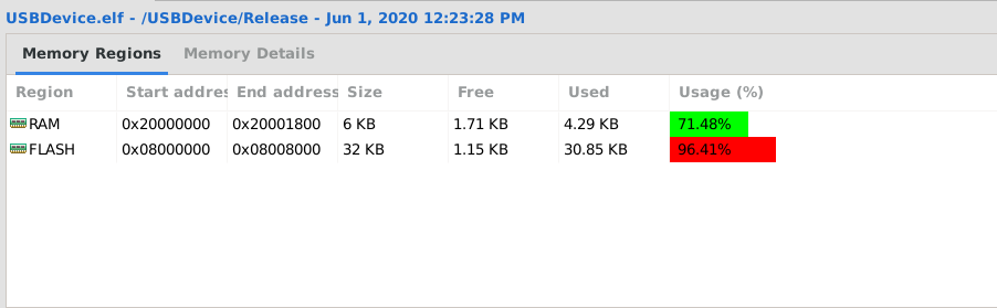

2020-06-01 3:25 AM
Guess this calls for the bigger STM32F070RB device (o;
Deleted some unneeded graphic functions and fonts...but when adding the PID controller:
