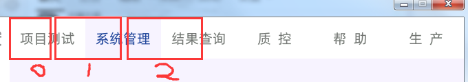

When setWindowSize(1) and setSnapping(true) (both Circular and not Circular ), the paramter itemSelected of void scrollTopItemSelectedHandler(int16_t itemSelected), is not in the right position.
itemSelected = 0, when clicked on the left part of ITEM 0.
itemSelected = 1, when clicked on the right part of ITEM 0 and left part of ITEM 1.
itemSelected = 2, when clicked on the right part of ITEM 1 and left part of ITEM 2.
In this case, I'll not know which item is clicked when itemSelected = 0, or 1, ...,
then I'll not know which view to switch to.
This is my question 2 in my tips.
