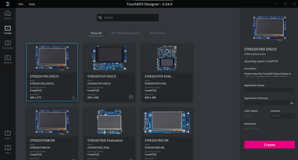

TouchGFX is an application that allows you to develop your GUI and connect it to your hardware. Therefore, your hardware should be operational for TouchGFX to be able to run on it. So, you need to set up your touch controller first, then TouchGFX can use that for detecting touch events in your application. Here you can access a document explaining how you can set up a touch controller connected to I2C. After ensuring the functionality of your touch controller (and the display), you can follow this tutorial to learn how you can setup specific functionalities for each button.
If you are using a custom board, then I suggest checking the rest of the steps in Board Bring Up documentation available here. However, if you are using one of the STMicroelectronics boards (usually, Discovery or Eval ones), you can use the available board configurations in TouchGFX to develop your application without worrying about setting up the board. You can just focus on developing your GUI.TouchGFX Board Setups
