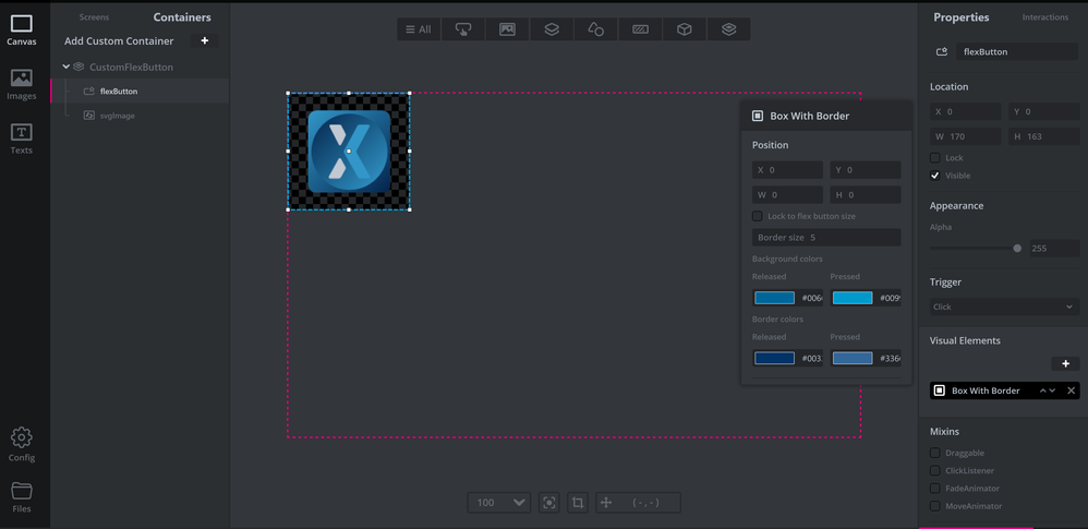

After discussing with the team, we have decided not to implement this feature for now. So, I suggest converting your SVGs to PNGs, or creating a custom container with an SVG and a flex button where the width and height of the flex button's Visual Element is set to zero.
Setting the visual element of the flex button to 0
I hope this helps!
