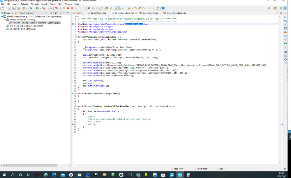

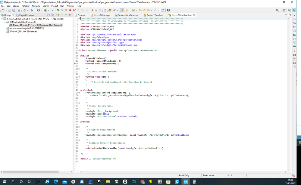

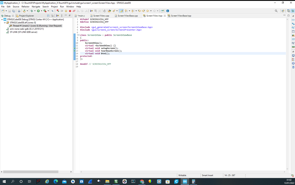

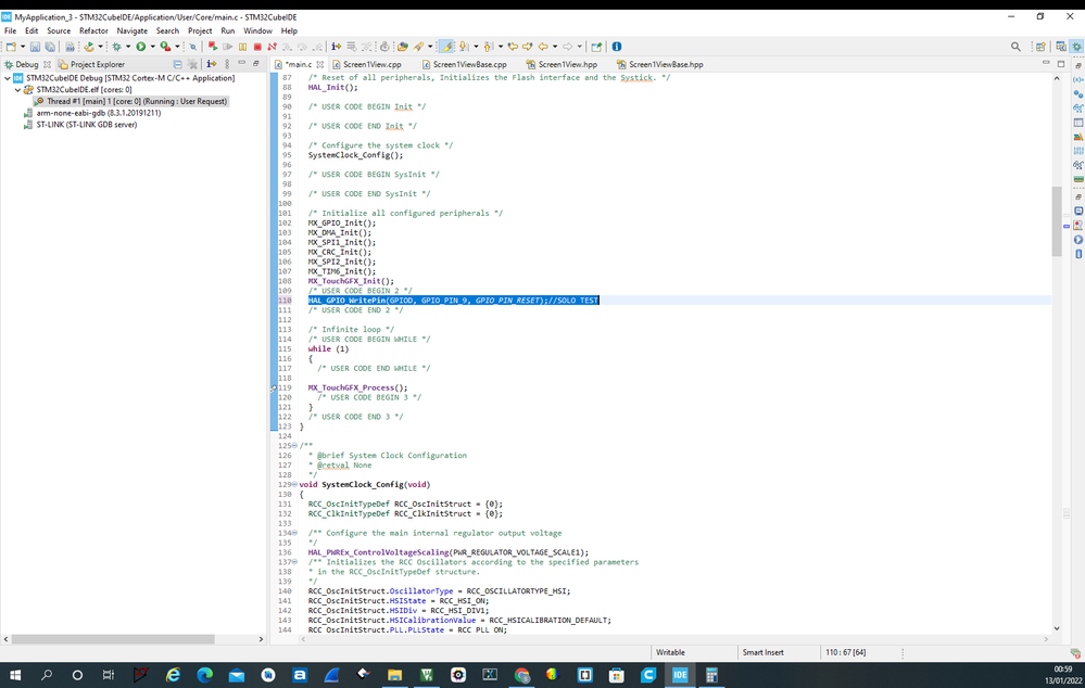

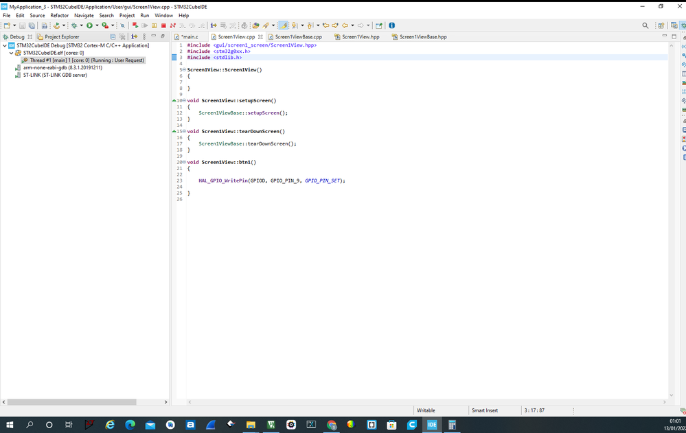

I start to wrote my tiny first application with touchgfc and STM32G071 nucleo i just put one button with label . I want control a led. my problem is when i touch the button on the display nothingh append i try to put one breakpoint in the btn1() functionbut it look like i never arrive, I follow step by steo the STM tutorial and look a couple of video on youtube i didi the same but nothing work .

Unfortunately the STM32G0 nucleo board does not handle touch :grinning_face_with_sweat:. If you wish to implement a button functionality for your UI you need to use the joystick or button on the board instead of a button widget, like in the demos available in TouchGFX Designer.
/Romain
