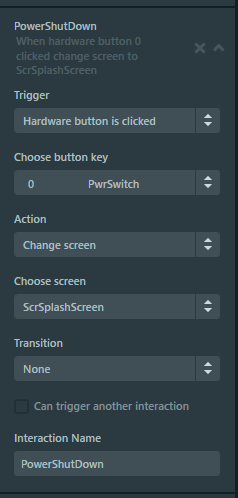

I have implemented a hardware button that changed the screen displayed.
It works fine when using the hardware.
I also want it to work with the simulator using the computer keyboard.
I think it is what the "Choose button key" in TouchGFX is for (correct me if I am wrong).
In the .touchgfx file I added the following:
"PhysicalButtons": [
"Key": 0,
"Name": "PwrSwitch"
],Then in screen interaction:
When running the simulator, I was hoping that by clicking on the computer keyboard "0" key, the interaction would be triggered. I tried both "0" key on the keyboard but nothing happens.
Please let me know if I am missing something.
Franck.

2021-02-01 9:33 AM
0 isnt key code , use ASCII "0" = 0x30 instead
2021-02-01 9:33 AM
2021-02-01 9:54 AM
That was it!
Thanks.
