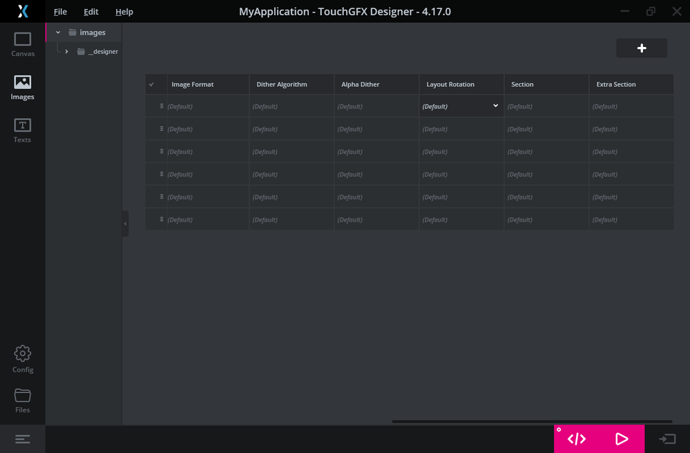

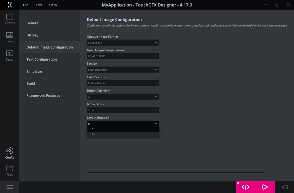

Basic user mistake. Set default image angle to 90 / 0 based to your hw lcd orientation.

@MM..1 Already I checked with both the orientations, same results.

Realy you regenerate code after change
and on all images have default ?

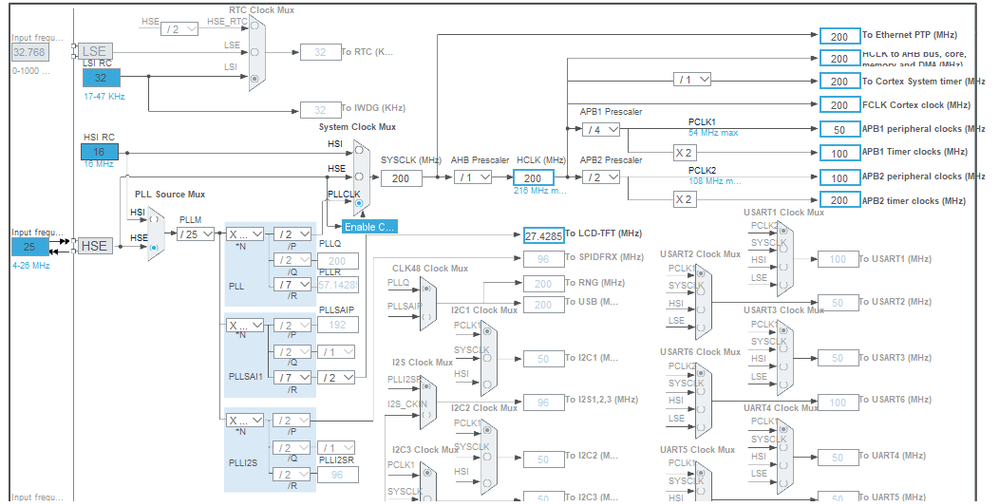

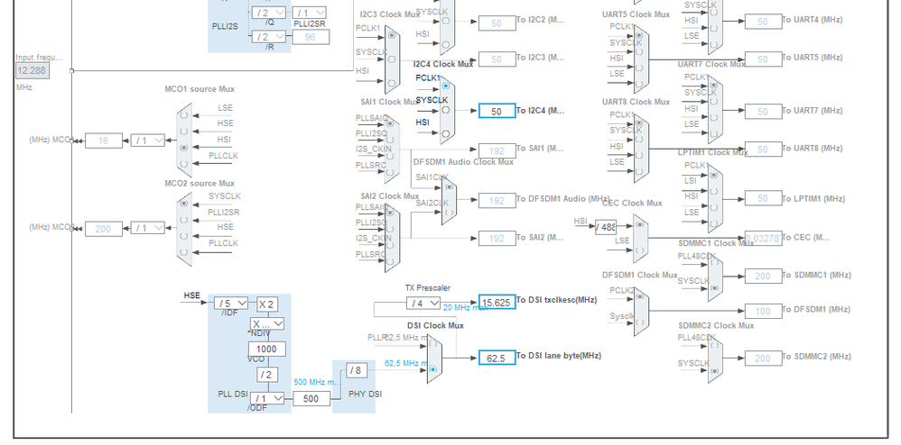

this looks more like a problem with your porch settings or the pixel depth.
you can clealy se *something* which means the system is running and the assets are there.
The skewing of the assets hints at some offset going wrong at the end of the line. Also - the bottom of the image shows 'random' noise which indicate memory without content.
2022-05-09 10:21 PM
@MM..1 I regenerated and dumped the code. Same result. All images have default.
