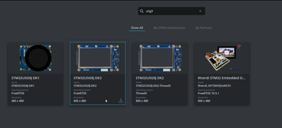

Unfortunately, I am unable to reproduce the issue.
I created a project by clicking on the TBS as below:
