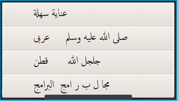

Hello Martin Kjeldsen,
this topic is very urgent for me, therefore I want to send you more hints from my problem.
This picture is, what I see in the designer:

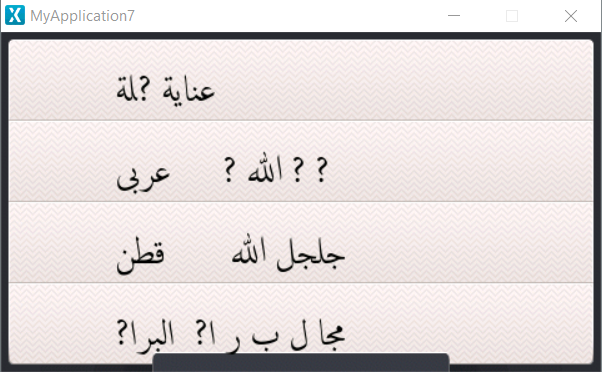

and this is the picture, what's the outcoming from the simulator:
Have you any idee?

2020-11-25 5:32 AM
Just to let everyone know, the issue was handled offline and was due to a font that did not cover all the right glyphs in the unicode range for arabic.
