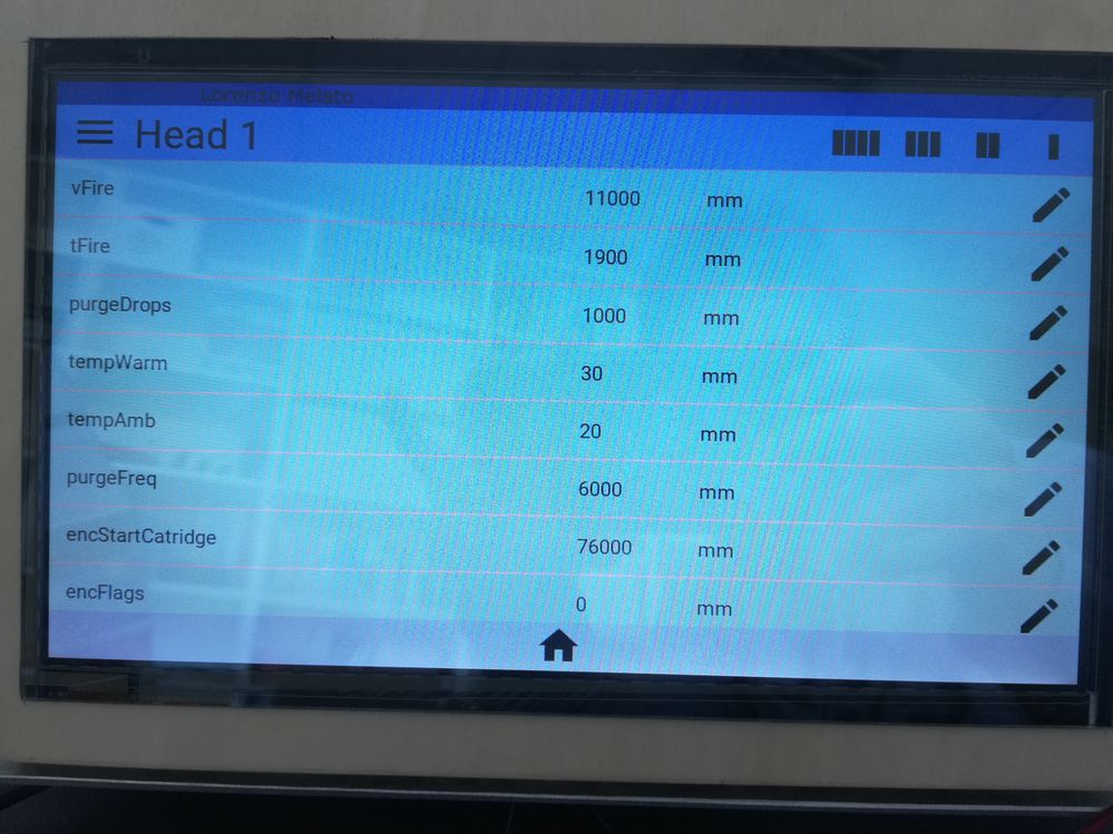

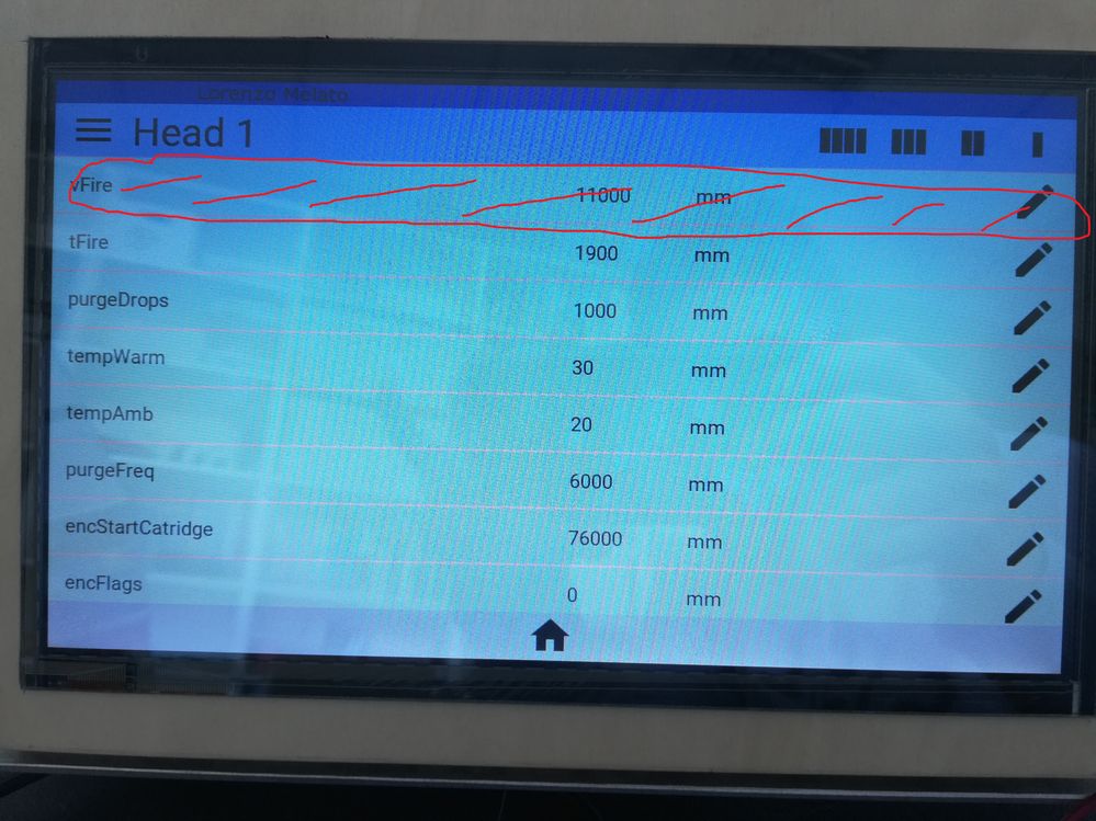

2019-05-16 5:25 AM
This is my screen
If i use
if(itemIndex == 0)
paramScroll.remove(item);I expecting that first line delete and i see scroll list without first object
so what do i wrong?
Thanks for help me.
2019-05-16 5:31 AM
Thanks. But what is the application doing when
if(itemIndex == 0)
paramScroll.remove(item);.. is executed? You're scrolling?
