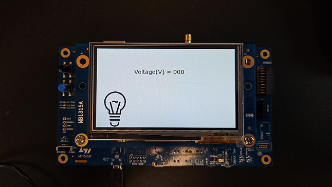

This is what my GUI looks like from a basic design.
This is what it looks like when I run the TouchGFX simulator(the right image is gone because I initialize it as false until it receives a signal)
This is the tearing image I am having trouble with(currently no inputs).

-> My first impression was that I was refreshing my screen to fast. I took out the .invalidate line, the gentlemen in the tutorials described it as a way to let the system know the widgets graphical representation needs to be reset. If I did that it would stop "tearing" and stay still, no matter what input I gave in D6(PD15) which I set as my GPIO Input.
-> I created a timer which would only call .invalidate every second. This partially worked! it correctly showed my inputs were working  and the images changed but alas every second before the new image showed up it would "tear". All other examples I saw of the STM32H735G-DK did not do this.
-> I looked more into invalidate. The closest I got to a proper explanation was that some boards use "Double buffer". Double buffer seems to be a way to ensure the board will not try to clear and write to the screen at the same time. I am unsure of how to find the option to start double buffering.

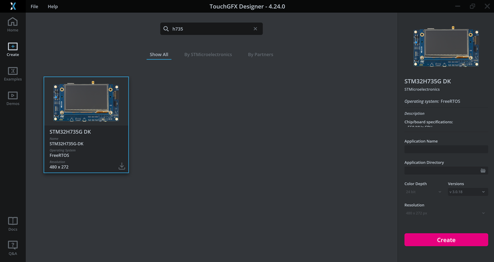

1- Create a STM32H735G-DK project from TouchGFX
STM32H735G-DK TouchGFX Board SetupSTM32H735G-DK TouchGFX Board Setup

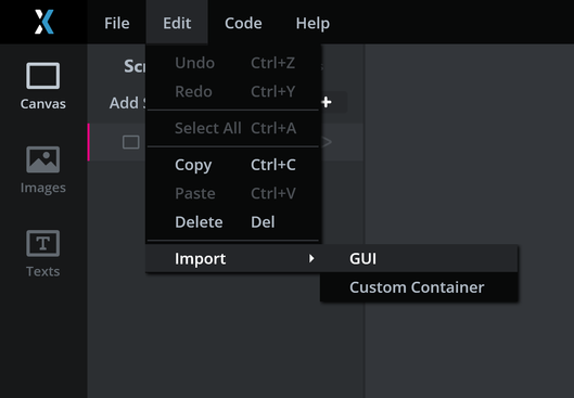

2- Import the TouchGFX application you have made:

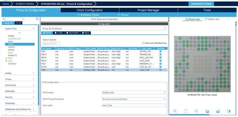

3- Add a random pin with the same name as the one you are using in your project and Model.cpp file (Input_Test):
Adding Input_Test pinAdding Input_Test pin
