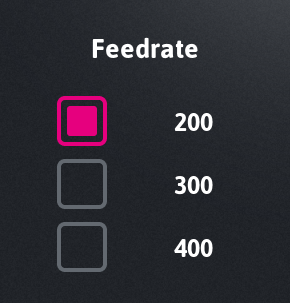

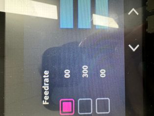

디스플레이를 터치하면 글자가 깨지거나 이상한 글자가 표시됩니다.
그리고 screen1에 여러 글자를 입력했는데 놔다 켜면 글자가 이상하게 나옵니다. 도움을 주세요.
이 사진은 touchgfx로 디자인된 오리지널 사진입니다.
보드에 이것을 업로드하면 위에처럼 이미지가 사라지거나 이상한 텍스트가 포함되는 경우가 있습니다.

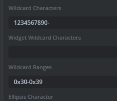

Font characters is added in code automatic only for static texts. When you manage wildcards in code, you need add chars manualy in designer font manager.
2024-07-04 11:15 PM - edited 2024-07-04 11:21 PM
I would appreciate it if you could explain it in more detail.
I'm not good at it yet so I don't understand what you explained.
The text was set as follows.
The numbers are set as follows.

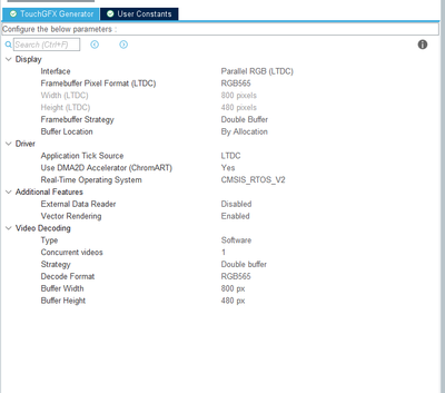

Could you please share more information on the MCU you are using, the framebuffer strategy, and the place where you store your text and font (internal flash or external flash)?
Are you using the same Typographies for both the numbers and "Feedrate"?
Could you please set the Fallback Characters to "?" to ensure the issue is not from the characters being unrecognized?

stm mcu: stm32f746
Text and fonts are stored in external flash memory.
Numbers and feedrate do not use the same Typographies.
I captured the settings in the photo above. Please take a look.
And I entered "?", but "?" does not appear on the display. The same symptoms as the screen captured above still appear.

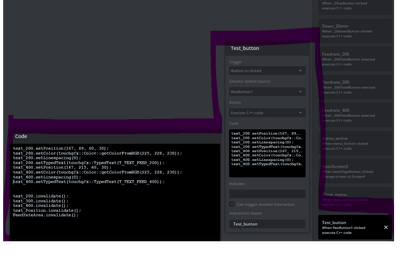

Let's do a simple test. Please create a button that by clicking on it, text areas are invalidated by using textArea.invalidate().
And also try invalidating the whole screen by just calling invalidate();
If the texts appeared correctly after the button has been pressed, it indicates the problem is most likely with the GUI; otherwise, you need to ensure that your external flash works correctly.

Start with change
remove upper and down change to 0-9
plus check if external flash is reflashed.

I tried the solution you gave, but
It wasn't resolved
In the photo below, I created a button and tried text.invalidate(), but the symptom is the same.

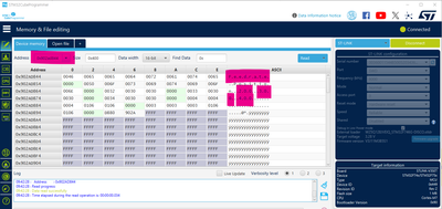

Also, I checked the external flash. Can you check if I checked it correctly?
I checked the external flash address where the text is stored and read the external flash memory, and the value was entered normally. Is this correct?
Since TextFlashSection and FontFlashSection memories are allocated from external to internal flash memory, they appear to work correctly.
If the external flash memory is faulty, shouldn't the image file be faulty as well? I don't understand why only the text image is displayed incorrectly. What is the cause?

I changed it to 0-9
The symptoms are the same TT
I erased the external memory and reloaded it, but the symptoms are the same. What is the cause?

The external flash data seems alright.
