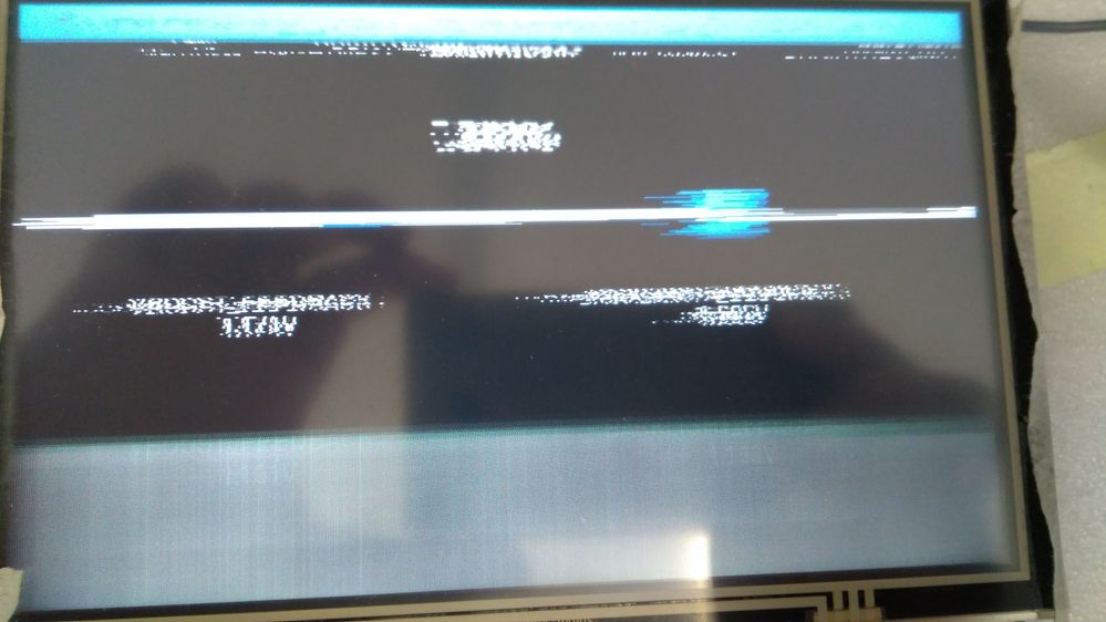

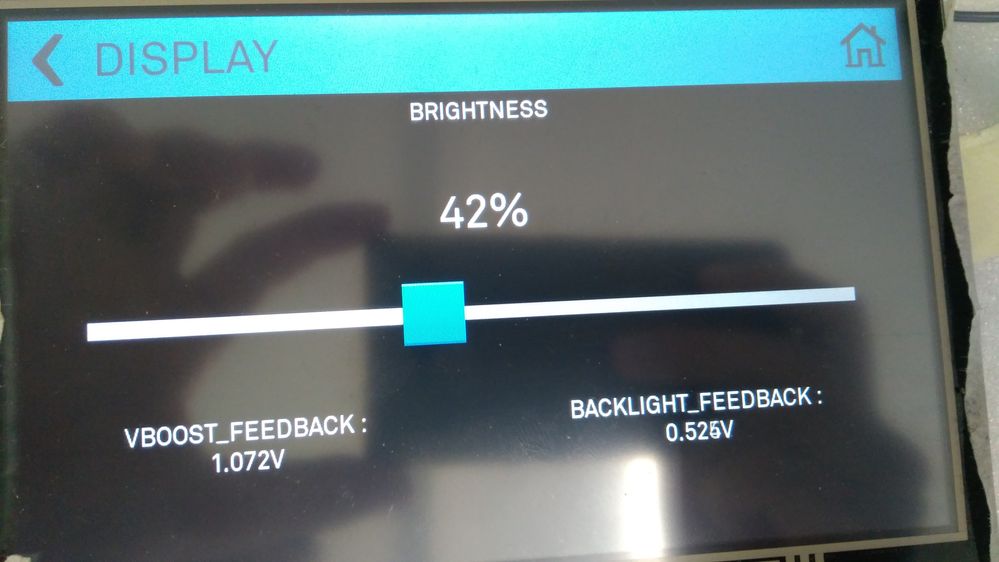

I can print nice pictures & transitions on the display of my custom board.
But when I'm rasing the brightness of the display (by setting the PWM backlight value), at a certain value the screen starts to flicker. Controls are shaking and if I continue to raise the brightness it flickers more.
Below that critical value it's working well, as you can see on the pictures joined.

solved, it was my input voltage that was dropping due to bad connectic
