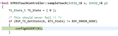

2023-10-05 6:42 AM
Your issue is as debuged in func BSP_TS_Getstate, then dont waste time with RAM , this is only side effect.
2023-10-06 11:13 PM
2023-10-07 1:37 AM
What you need elaborate , if your code breaks here
error is returned ,then check why .
