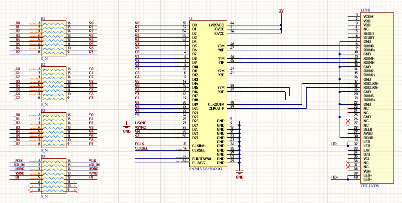

Hey,
You can use RGB to LVDS bridge IC from TI DS90C385A
2023-10-24 7:02 AM
Thank you. It is disappointing the LVDS output was not implemented in the STM32 to begin with, as it seems to have become a de facto standard for bare displays. Having said that I have talked to a local screen manufacturer and it seems that the 2-lane MIPI/DSI bus could be configured to drive a 10.1" screen, but at a lower refresh rate and/or resolution. I may post some follow-up videos in the case that I am able to attach the screen directly to the discovery board. The layout for the DS90C385A interface will have to wait for a while.

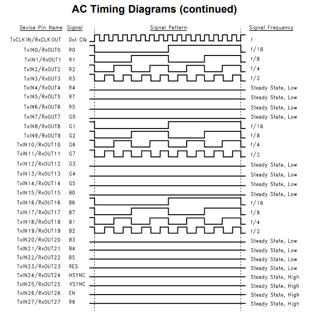

Thank you very much for the solution. I have looked into the DS90C385A datasheet and the assignement of RGB lines to the pins seems quite disorderly and chaotic (but most likely on purpose?). It seems that you have the same assignment in your schematic. Is this assignment compatible with most screeen manufacturers or is that assignment vendor specific?
2023-10-28 3:01 AM
Yes,LVDS Should have been implemented in the high-end STM32H7 models it would have been quite productive.You can directly connect the LCD with the DK I always use this method while confirming my schematics and development phase.
2023-10-28 3:03 AM
Generally we see a lot of Manufacturers using these connections that uses FPC as general setup but you have to check with the datasheet for pin outs which sometime are manufacturer specific.
