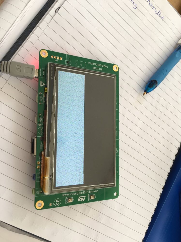

2020-01-31 3:40 AM
Hi Martin,
i have tried several times the following:
any idea of what might be going on here, it is quite difficult not being able to debug in CubeIDE so i am at a loss. any help or guidance is greatly appreciated
regards
Barry
