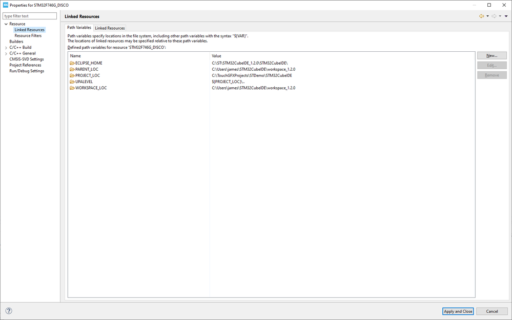

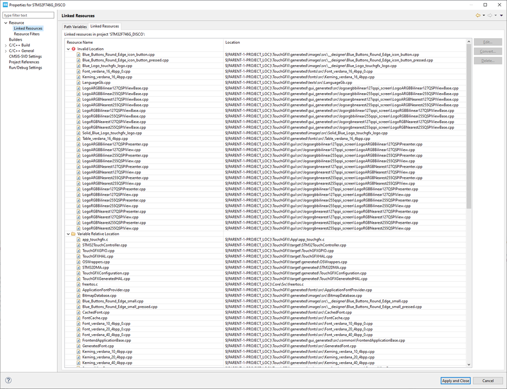

I went to attempt something similar, but instead I just wanted to try and delete these files. When in STM32CubeIDE I tried to delete the files and the STM32CubeIDE presented this dialog:
That got me thinking about linked resources in other projects I have worked on, so I went to view all of the linked resources in this project. Right click the project->Properties->Resource->Linked Resources-> then click the linked resources tab. I then see a list of all the linked resources:
I did not link these resources, TouchGFX must have created these links when generating the project.
Clearly there are "Invalid locations". So I browse to these locations on my disk, and yep, these files don't exist. There are similarly named files, but not the correct ones.
The Path Variable that is being used to generate the links for the resources is odd, and doesn't show in the Path Variables tab either:
