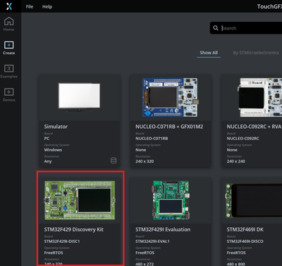

As stated by @mathiasmarkussen , why don't you start from TouchGFX designer based on TBS available and select STM32F429-DISC board as shown below?:

Try starting your project from the TouchGFX Designer instead. A complete Board Setup is supplied for STM32F429I-DISCO. You can than modify according to your needs from there - or you can analyze the project to figure out what you need to change in your own project if you prefer.
