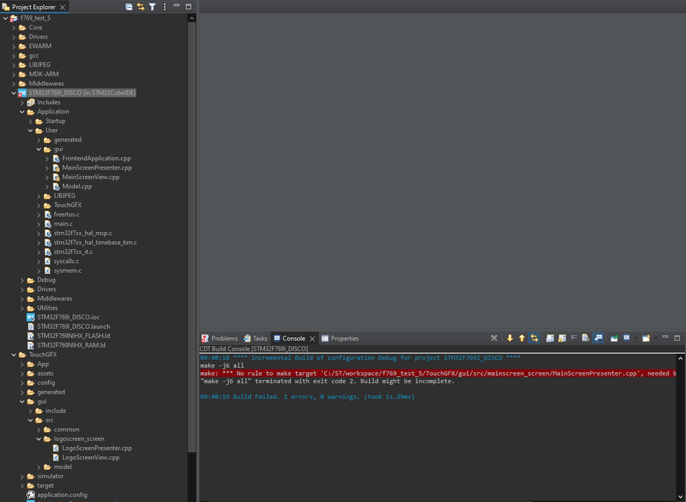

I am trying to get familiar with the workflow for using TouchGFXDesigner with CubeIDE, when I create a project with the designer and import it to the CubeIDE all works fine, but for example I change the name of a screen in the designer and regenerate the code, then the CubeIDE project still reflects the old name for the screen and does not compile anymore.
Is there a way to regenerate all files so that the project in the IDE is correctly updated?

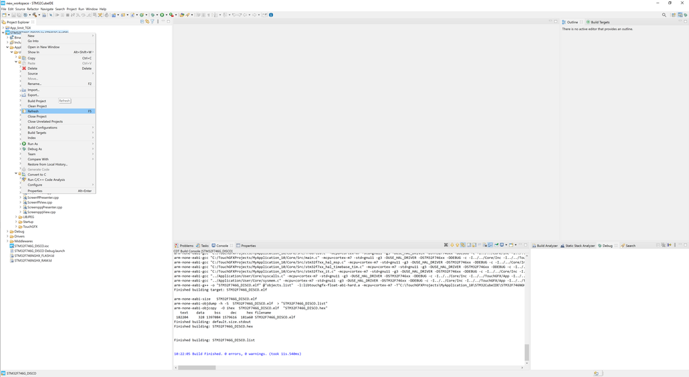

Hello @JVALL.1 ,
Did you try to press "Refresh" in CubeIDE?
That should update information about your project.
Let me know if that resolved your issue.
/Yoann

When you mentioned if I refreshed the project I thought I already did so I did some more testing and got what I think is some strange behavior, maybe you can give some clarity, here are the steps I am taking.
Using IDE 1.10.1 and Designer 4.20
At this point I have not been able to update the project correctly anymore.
Should I import the projects into the IDE using a different approach?
Also noticed that it's not possible to have two projects for the same board at the same time in the IDE, is this maybe related to the Designer always using the name of the board for the project name?
