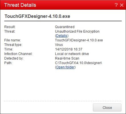

After investigation, it was automatically deleted by the Anti-Virus software (Trend Micro OfficeScan Agent). It stated that Virus was found in the Designer, and therefore it was deleted automatically.

2020-02-17 11:42 PM
Sometimes virusscans flag something they haven't seen before - McAfee does the same thing for us here. We run virus scans before releasing new versions of TouchGFX.
2018-12-18 2:00 AM
Most likely it's a false positive. Try to check the file using VirusTotal to see how many AV vendors are detecting a threat there.

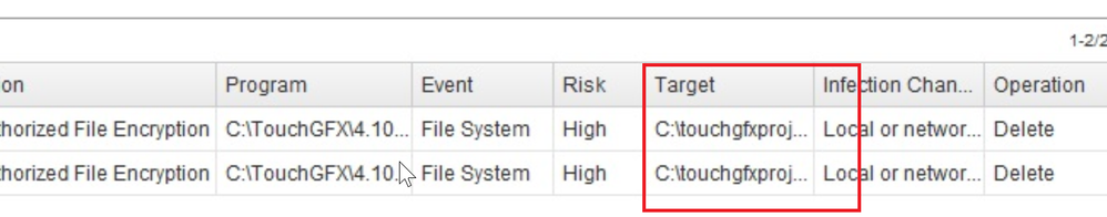

2018-12-20 6:21 AM
Hi S.P.,
I've tried to figure out what might be triggering this "File Encryption" warning.
TouchGFX Designer does not encrypt files, but copies-, creates-, deletes-, modifies- and generates them. It also calls external processes (e.g. make, gcc, font- and image converter tools). I've heard about this warning sometimes being related to a subprocess.
Is it possible for you to provide me with the full "target" path from that screenshot? Then we might become wiser as to what kind of subprocess is causing this "false positive".
Thanks!

2018-12-20 5:09 PM
Here it is.
After clicked "Details", it goes to "https://www.trendmicro.com/vinfo/us/threat-encyclopedia/search/unauthorized%20file%20encryption", which doesn't help much.
Thanks, Martin
2018-12-20 11:40 PM
Hi SP,
I'm talking about these "target" paths, that are obscured in the screenshot. Thanks!
2018-12-20 11:48 PM
This are the paths of the pictures that I have deleted in Step (2) .
"C:\touchgfxprojects\myapplication1_4_10_0\assets\images\xxxx.png"
2020-02-07 5:11 AM
TouchGFX just deleted itself on my computer too. Target is here
2020-02-17 6:11 AM
And this is Trend Micro OfficeScan Agent, or what?
2020-02-17 7:05 AM
Yes this was Trend Micro OfficeScan Agent. I had my company whitelist TouchGFX 4.13.0 so it won't cause any issues for the time being.
