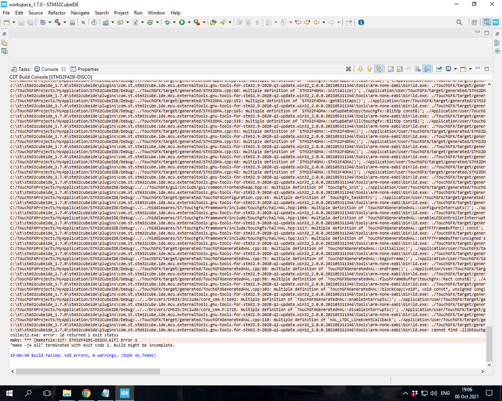

0693W00000FBg6XQAT.pngHi Imen. I managed to get rid of the simulator files but I am getting compiler errors such as the ones above. I followed the prompts from another ST Microelectronics video (https://youtu.be/VOs2LYO7wSA) but the solution shown has not solved the problem. Any aassistance regarding this matter will be apppreciated.
Lebohang.
Hi TDK I have since resolved that issue. However I am faced with complilation errors. Please see the image below:
Thank you Andrew, I have resolved that matter and been met with compilation errors since. It's frustrating at this point.
would be better to copy & paste the text - your image has truncated the messages.
Fortunately, when you get loads of messages like that it's often down to just one problem (or a few problems) - fix them, and all the messages will go away.
The key is to address the earliest-reported message first.
Hi Andrew
The text (manually truncated ) is shown below, it extends for 500-odd lines in my console:

You have multiple source files redefining functions. Having two main.c files within a project should not happen.
