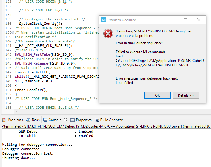

Another issue, whenever I generate the project through TouchGFX for this board (STM32H747 Discovery), when I try to flash the program on the board in STM32CubeIDE, the M7 core has a problem, "Debugger connection lost" as shown in the image. I've already tried following the tutorial from section 3.1 (https://www.st.com/resource/en/application_note/dm00629855-getting-started-with-projects-based-on-dualcore-stm32h7-microcontrollers-in-stm32cubeide-stmicroelectronics .pdf) and I was unsuccessful. Can you help me?
Image showing the problem:
On the M4 it works fine.

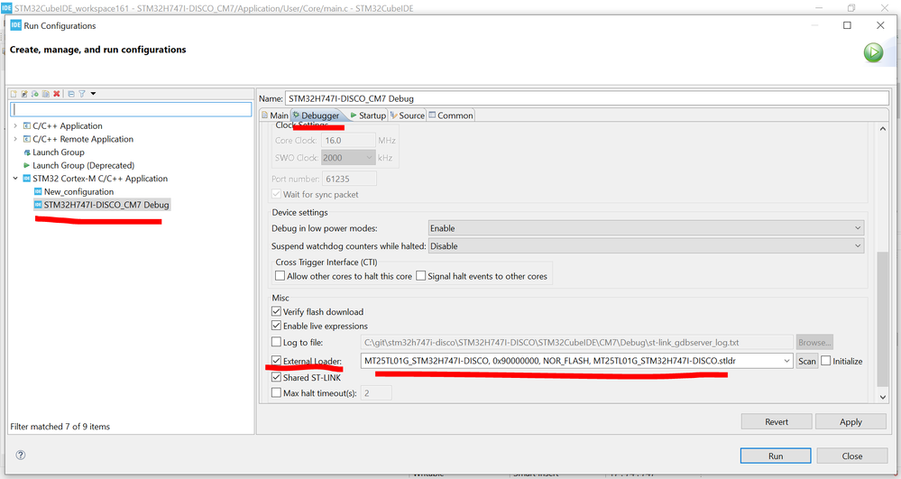

The Debugger connection lost is the expected behavior. From the Error message it seems like you need to enable the external loader for the STM32H747 disco board. In STM32CubeIDE go to the "Run" tab on the top, and click on the "Run Configurations" option. In the new opened window go to the Debugger tab and scroll down to the bottom and check the "external loader" option. Make sure you select the MT25TL01G_STM32H747I-DISCO.
/Romain
2021-07-12 7:53 PM
It works!! Thanks
2021-07-12 11:56 PM
Perfect :thumbs_up:
