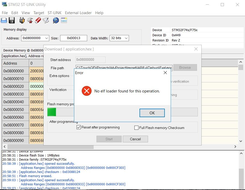

I also tried to program using ST-LINK Utility and got an error:
The logical question is whether this will be fixed in the next update, because in version v1.1.0 it works fine?

Maybe V1.0 supported a flashloader for the QSPI directly in the EWARM project. But this is definitely not something that we'll be doing going forward - It's too much work because we sometimes have to make them ourselves.
Using ST-Link, could you try the following?
1) Upgrade the firmware on the chip (ST-Link -> Firmware update)
2) Make sure you've specified the flashloader for the STM32F746G-DISCO under "External Loader"-> "Add External Loader". And find "N25Q128A_STM32F746G-DISCO"
/Martin
2019-06-07 2:43 AM
2) Make sure you've specified the flashloader for the STM32F746G-DISCO under "External Loader"-> "Add External Loader". And find "N25Q128A_STM32F746G-DISCO" - it really worked.
