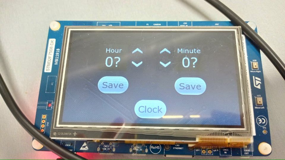

I'm new with TouchGFX and I'm doing official TouchGFX tutorials.
I came up with the problem - code is properly generated and target/simulation can be run, but when I use buttons up/down then not number but question mark is displayed.
I'm using STM32F7508-DK.
Does anyone have any idea what is the problem?

You need manage characters used in application fonts in designer typography lists. Not listed is replaced with ?

@MM..1 It works! Thank you! :)
