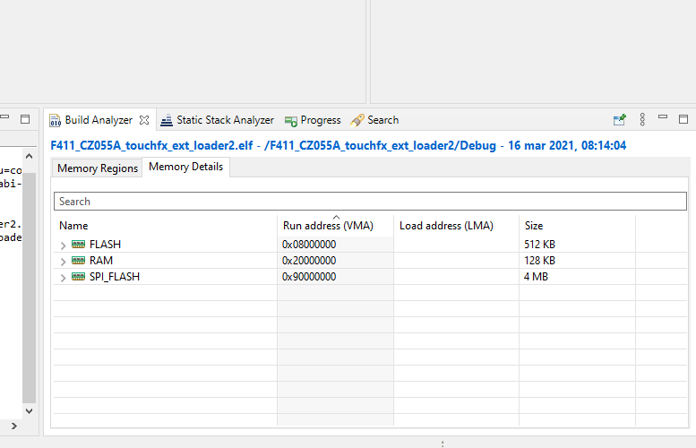

I am developing an application with:
I have already created the .stldr file for this memory and it works fine.
I edited the STM32F411RETX_FLASH.ld file to add the external flash.
I create the project from CubeMX, enable TouchGFX, create a test screen and do "Generate Code".
Why are the .bin files of the bitmaps and fonts not created to put in the external flash?

I create a screen with TouchGFX, press "Generate Code", compile with STM32CubeIDE and everything goes well. The problem is that if I launch the debug from STM32CubeIDE it seems that I cannot find the .BIN file to load in the external flash memory ...

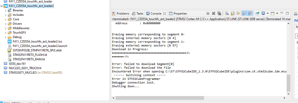

2021-03-16 2:57 AM
I have created an external loader called "SST26VF032B_STMF411RET6_SPI2.stldr" and it works correctly with "STM32CubeProgrammer".
If I launch the debugger it gives me an error as you can see from the attached photo.
Am I wrong to place my external charger in the project?

2021-03-16 11:59 PM
With Cube Programmer I can write and verify correctly through my custom external loader ...
I think that the only solution to use custom hardware without starting from the demoboards, is to modify the Makefile, perhaps taking a cue from the NUCLEO-G071RB + X-GFX01M1 demoboard.
Where is the Mekfile to be modified?
Thank you

2021-03-17 1:39 AM
Thanks for the reply.
I saw that in the LOG it gives me this error:
