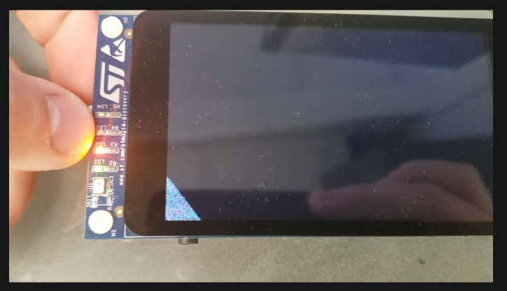

2020-05-04 9:45 AM
Hello Martin,
You may find the picture of the issue attached above.
The issue happens for couple hundred milliseconds on startup.
It took me a while to circle back to this project, sorry for the delay.
Best,
Tuna
