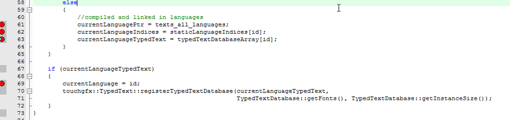

2020-02-13 8:02 AM
Additional info
system go to HardFault after string "currentLanguageTypedText=typedTextDatabaseArray[id]; "
