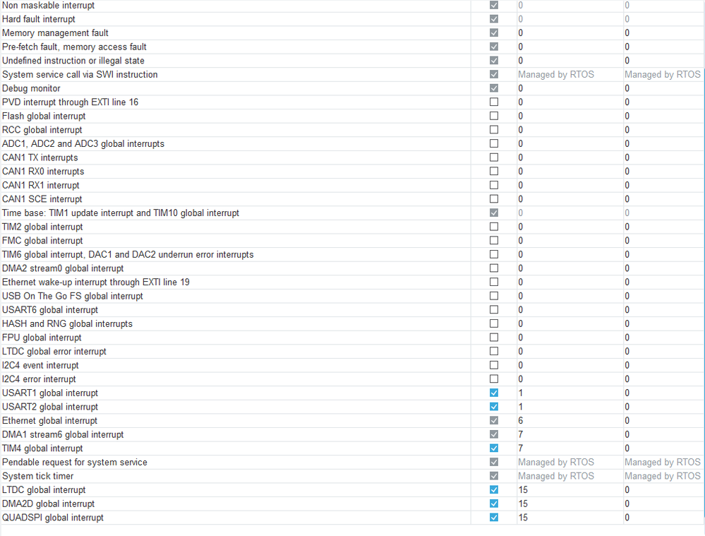

Hey @MM..1 , sorry i forgot to mention that I'm using FreeRtos. I already tried correcting priority levels but I couldn't get it working any better.
Here is screenshot of priorities :
FreeRTOS priorities:

As first try change ethernet to DTCM ram. And RTOS when i good understand, need all other irq lower except...
