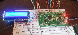

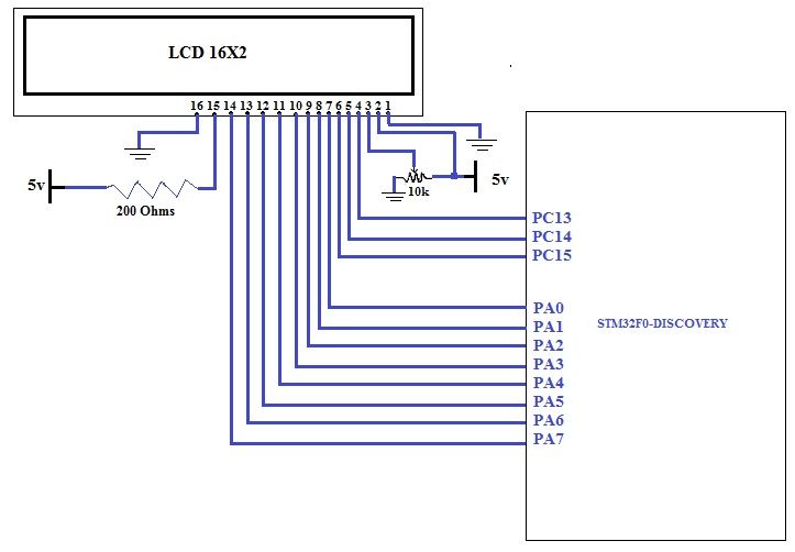

hi
i want show a text in LCD and i use LCDTS1620A-21 and stm32f0discovery#include ''stm32f0xx.h''

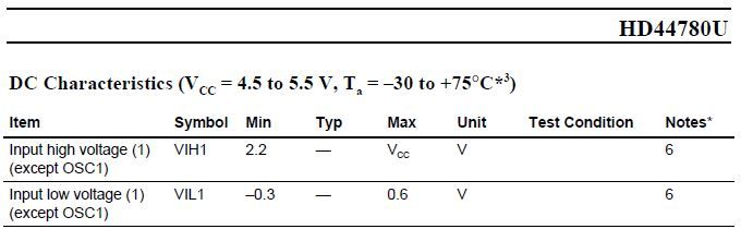

Didn't really looking at the code.
But driving a 5.0V peripheral (LCD) from a 3.3V MCU, this can't work.2015-02-26 12:59 PM

The inference is that the VOL/VOH levels are incompatible. I've not looked at the data sheet for this specific display, so honestly couldn't say one way or the other. I'm using a similar one, but it's 3.3V rated.
http://www.newhavendisplay.com/specs/NHD-0216HZ-FSW-FBW-3V3C.pdf
Other peoples register level code really isn't something I'm going to spend my time on. Would suggest you look at other implementations using the Standard Peripheral Library.Connectivity otherwise doesn't look bad, but you'd want to walk through the code, make sure the delays on the pins/signals are what you expect, and debug to understand if it's getting stuck somewhere, just not responding as expected.2015-02-26 3:14 PM
''But driving a 5.0V peripheral (LCD) from a 3.3V MCU, this can't work.''
Except my friend - for those times - when it (surely) does! Might (some) attention be paid to LCD's data manual? I extract key portion, here:
