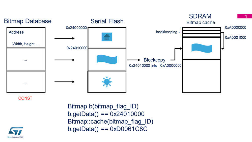

The bitmap database is "constant", the cache functions do not interact directly with it. When the programmer requests a bitmap to be cached, TouchGFX finds the address of the bitmap in the flash and copies data from here. I've made a very very poorly done schematic of the process.
("getData" returns a pointer to the Bitmap data, this is just to show you that when you cache a bitmap, TouchGFX copies the pixels from the original location to the bitmap cache using the BlockCopy function you wrote.)

Your graphic is good. It cleared my understanding.
I understand the bitmap_database is constant. but when I meant bitmap database I mean some fictional internal array which touch gfx uses.
After I did cache all. when I do the b.getData(). I am getting the new cached address. But still the image dont appear on the screen. I strong feeling is still it is looking in the old location.
