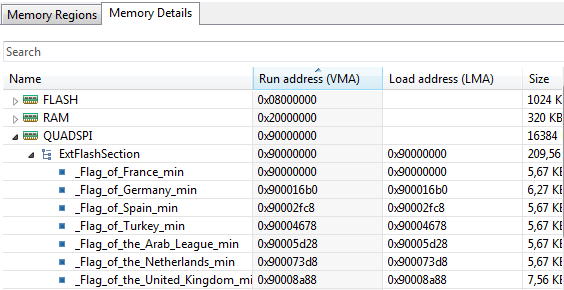

I followed as well this tuto to configure the linker under CubeIDE (I think that is it the same as AtollicTrueSTUDIO):
All is building perfectly and when I look at the Build Analyzer, I can see the ExtFlashSection and my assets under QUADSPI, all seems in order:

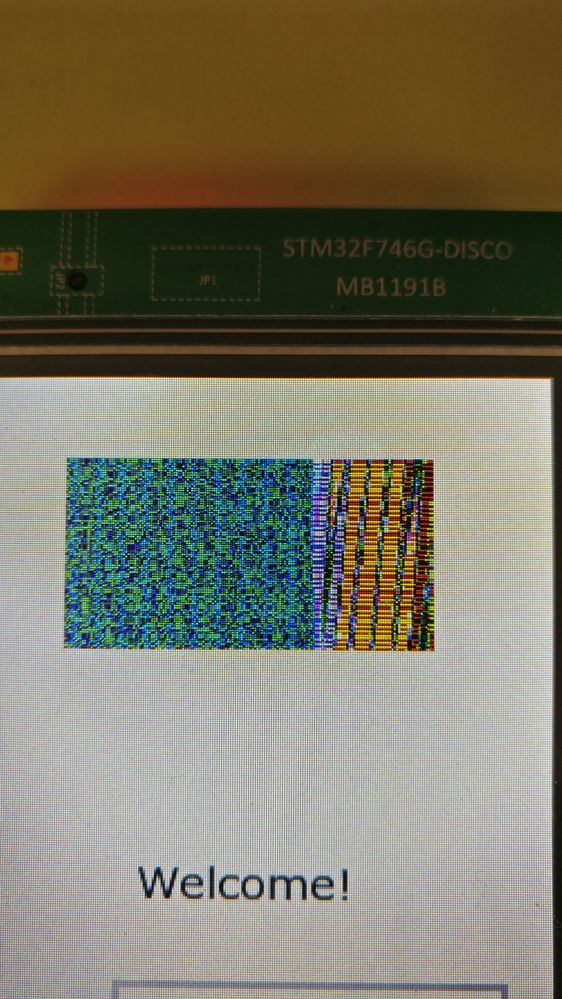

The problem is, when I launch the debug, it seems that the flash is not programmed and my screen print this instead of my beautiful picture :(

Hi again,
CubeIDE is also relatively new to use here. I'm not sure whether or not it uses ST tools internally to program flash if that memory range is present in the application. If you use ST-Link or CubeProgrammer to program the external flash and then attach your debugger i'm sure you'll have good results.
/Martin

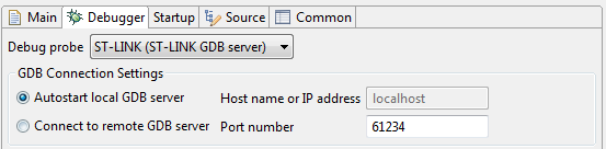

2019-05-14 12:40 AM
Hi Martin,
Sorry, I wasn't clear in my first message, I'm using STM32CubeIDE with my STM32F746G-discovery, I have tried Atollic but I'm not using it. When debugging or programming, STM32CubeIDE use ST-LINK:
Thank you,
Charles

2019-05-14 1:56 AM
Thank you Martin,
Using STM32CubeProgrammer to set an external loader and then configuring STM32CubeIDE with this external loader, I managed to really programmed my QSPI Flash.

2019-05-14 2:29 AM
In fact, I just realize that I didn't really need STM32CubeProgrammer or ST-Link to set up the external loader.
It is possible to set it up in STM32CubeIDE by going in:
Run>Debug Configurations>STM32 MCU Debuging>"yourapp.elf">Debugger and then check "External Loader" and type "N25Q128A_STM32F746G-DISCO, 0x90000000, NOR_FLASH, N25Q128A_STM32F746G-DISCO.stldr" (in my case), the scan button don't work and find an innacurate loader.
I had already set this external loader with STM32CubeProgrammer so I don't now if it was necessary. I will try it on free time but I think that only the CubeIDE config is necessary.
Now everything is set up, I can flash from CubeIDE with on click :D
