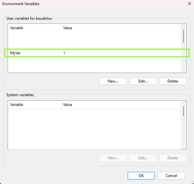

You are welcome, I just add it to all the env var, but maybe if you just created it restart VS,
And in vcxproject file :
I hope it helps,
