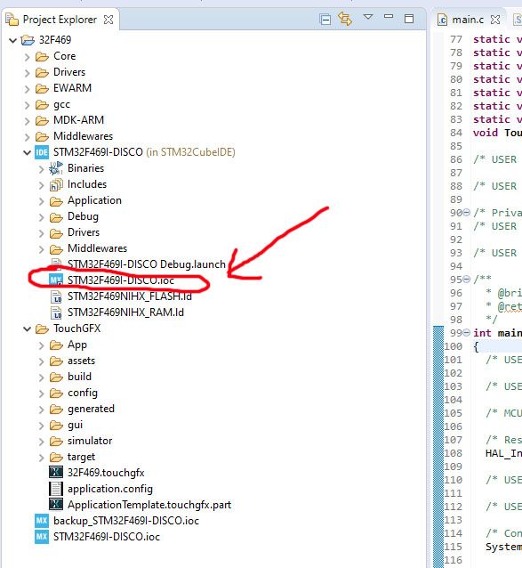

this is the error I am getting once I migrate or click continue when I open project in CubeMX 6.0 or CubeIDE 1.4 created in TouchGFX 4.14
then screen created in TouchGFX will not longer display, it just dark.

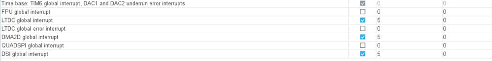

After some investigation, your problem might be due to NVIC priorities being reset.
Indeed, when updating to CubeMX 6.0.0, the NVIC priorities are reset because the CubeMX team made some changes regarding the priorities linked to FreeRTOS. This is a bug that is only noticeable when using FreeRTOS. If the priorities are at 0 the interrupts won't be triggered. So set the priorities of interrupts that are enabled such as LTDC or DMA to 5.
Tell me if it solves your issue.

  • Change the NVIC priorities (see below)

I have the interrupts like you show me. But it shouldn't ask you to migrate whne you open in CubeIDE 1.4 after you created in TouchGFX 4.14
