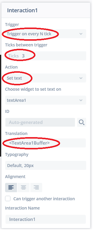

Please note the interaction below trying to update text using the value in the buffer (not working)

Hello @ksale.1 ,
Why not simply use Wildcards for displaying your value in the TextArea ?
That could be way more easy and you would be able to still use the Unicode::snprintf() method to achieve it.
/Yoann

I've achieved it programmatically in handleTickEvent()
void Screen1View::handleTickEvent()
boxProgress1.setValue(flow);
Unicode::snprintf(textArea1Buffer, TEXTAREA1_SIZE,"%u", flow);
textArea1.invalidate();
}can set text do the same?

Hello @ksale.1 ,
/Yoann
