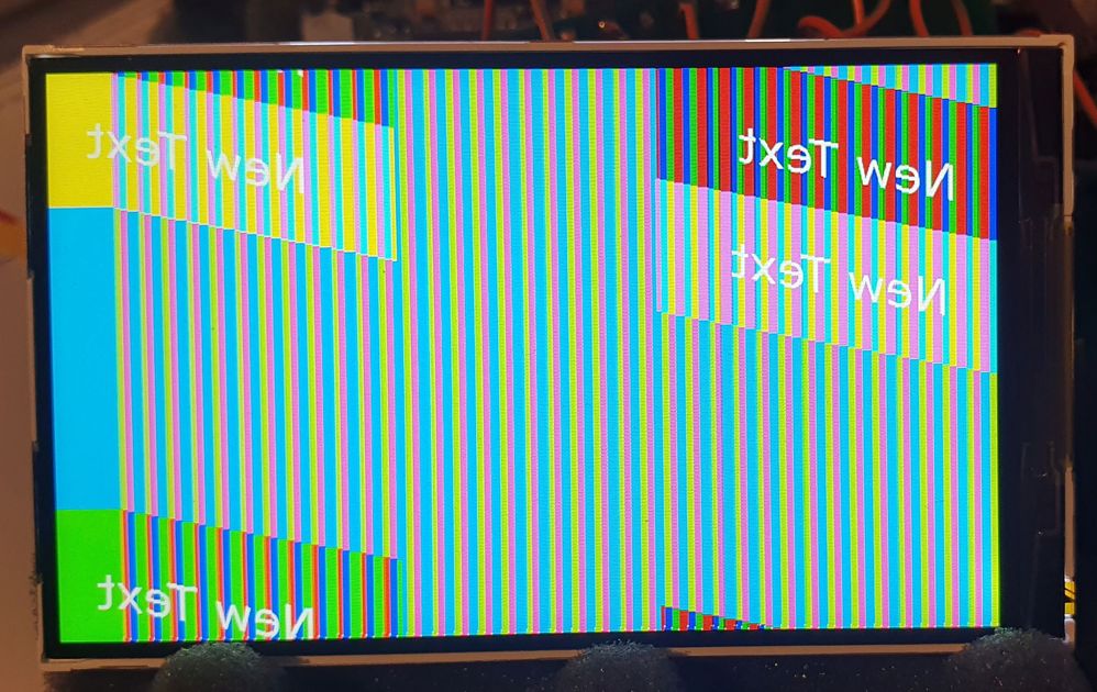

This is what my display actually show:
Using this settings:

2022-02-24 8:47 AM
Then try change to video mode
VidCfg.Mode = DSI_VID_MODE_BURST;
VidCfg.PacketSize = 480;
VidCfg.NumberOfChunks = 1;
2022-02-24 9:01 AM
Closer and closer....
Some pixel on the left side are clear now....
2022-02-24 9:15 AM
Now try decrement/increment by 1
VidCfg.HorizontalSyncActive = 31;
VidCfg.HorizontalBackPorch = 31;
VidCfg.HorizontalLine = 1015;and for rotate mirror use datasheet register command...
2022-02-24 10:56 AM
Unbelievable!
You are a hero.
That made it. SyncActive and BackPorch seems to have no effect, i can change with whatever i want.
HorizontalLine 1014 makes it good but a few pixels on one side are still bad.
1013 and half screen is bad. But increase it by 1 to this values the screen is clear.
VidCfg.HorizontalLine = 1016;Thank you so much.
Send me a message with your paypal please, i want to say thankyou with a beer :)
