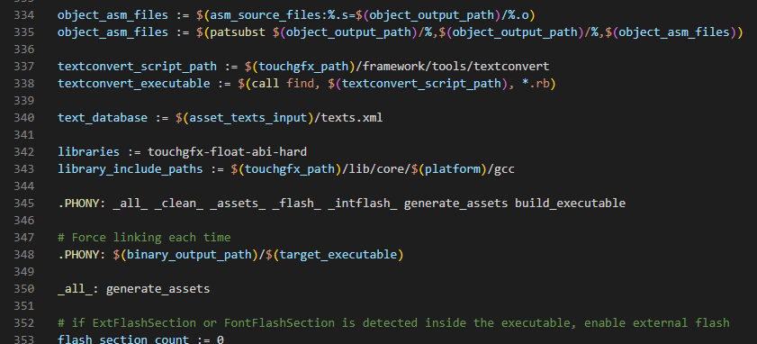

Go into the CM7 makefile for your project and change "text_database := $(asset_texts_input)/texts.xlsx" to "text_database := $(asset_texts_input)/texts.xml". That did the trick for me, and you will only have to do this once. I have regenerated code in TouchGFX Designer multiple times and it didn't overwrite this ammendment. I think it's because ST switched the text format from .xlsx to .xml recently... Hope this helps! 0693W00000KaaRtQAJ.png
