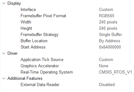

I made the project for a custom SPI display with configuration like screenshot below:
