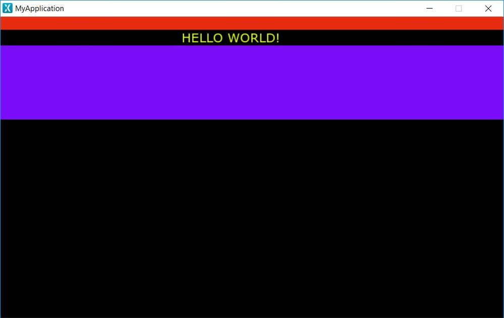

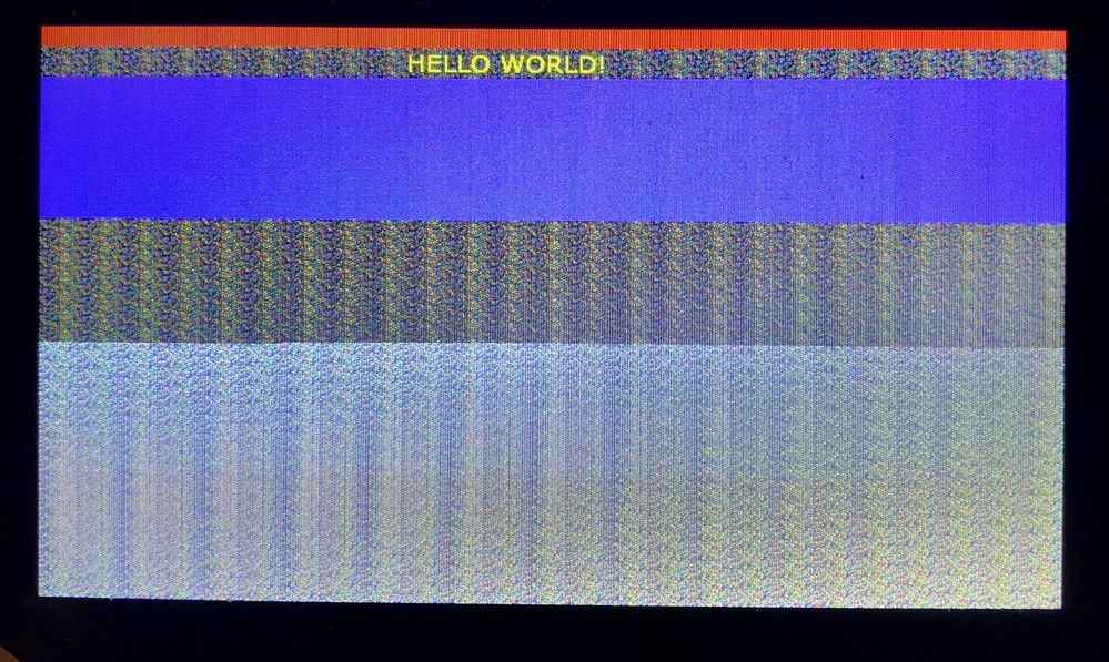

Hi Martin,
I've made some progress on this. Here is what TouchGFX simulator shows, followed by what my display is now showing. I've experimented with various clock speeds and other settings to get it to this point. I'm getting FIFO under-run errors if I run the LCD clock faster than about 8MHz. I never get a clean image on the screen though. It seems like the image I want is painted, and then a bunch of noise sweeps over it at regular intervals.
Terry
2019-08-22 12:12 AM
Hi, okay, so you've got some memory contention issues. You can try locking dma to front porch so that DMA and LTDC never access SDRAM at the same time (if you're running double buffering).
hal.lockDMAToFrontPorch(true);
2019-08-22 8:42 AM
Hi Martin,
I was actually set to single buffering. I tried setting double buffering and setting the lock as you suggested, but this had no effect. Any other ideas?
Terry

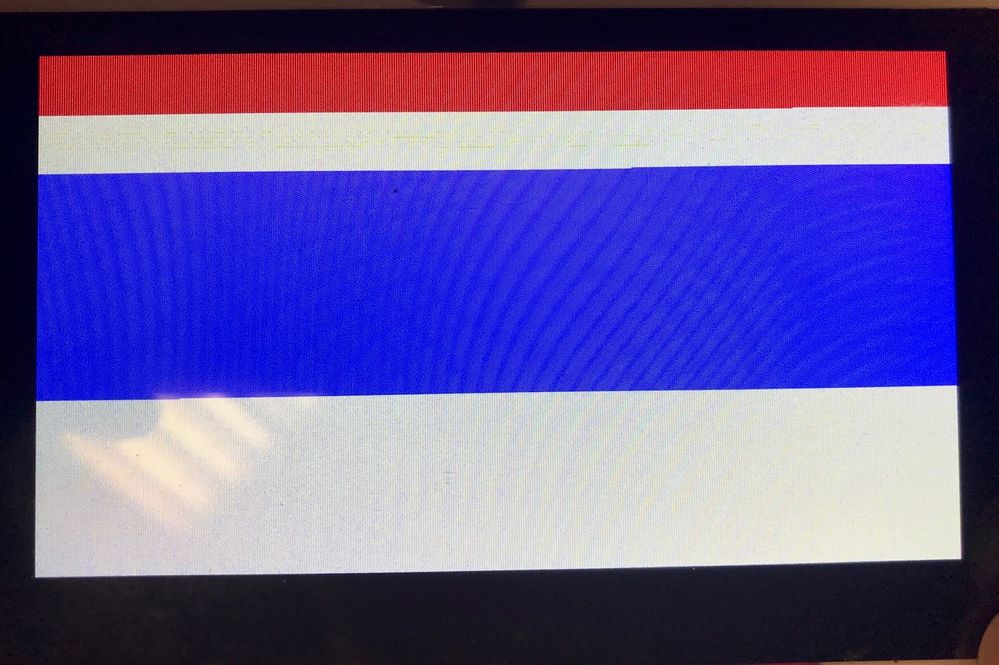

2019-08-22 12:30 PM
What is the black part of your application? Is that an actual box or an image? If you have nothing as background in your application you'd be staring into uninitialized framebuffer memory.
2019-08-22 12:34 PM
I haven't specified a background box in TouchGFX. In STM32CubeIDE, I've set the background colour to white in the LTDC settings by setting the red, blue and green colours to 255.
2019-08-22 12:37 PM
Okay, try creating a background box. TouchGFX uses double buffering by default, so you could be seeing something related to LTDC defaults and garbage memory in a different buffer since there's no TouchGFX widgets covering that area / getting drawn into the framebuffer.
2019-08-22 12:40 PM
Thanks. I will try that and get back to you shortly.
2019-08-22 1:24 PM
Thanks Martin! I still get an interrupt saying the FIFO underrun error has occured, but then after the underrun interrupt is disabled, it runs as expected.
I set a breakpoint in STM32f4xx_hal_ltdc.c to show you where that occurs:
/* FIFO underrun Interrupt management ***************************************/
if (((isrflags & LTDC_ISR_FUIF) != 0U) && ((itsources & LTDC_IER_FUIE) != 0U))
/* Disable the FIFO underrun interrupt */
__HAL_LTDC_DISABLE_IT(hltdc, LTDC_IT_FU);
/* Clear the FIFO underrun flag */
__HAL_LTDC_CLEAR_FLAG(hltdc, LTDC_FLAG_FU);
/* Update error code */
hltdc->ErrorCode |= HAL_LTDC_ERROR_FU;
/* Change LTDC state */
hltdc->State = HAL_LTDC_STATE_ERROR;
Here's the screen now:
