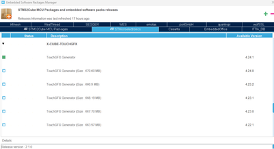

Show your image list TouchGFX versions , as you see on my 4.24.1 is marked red = not usable with IDE and MX version. But 4.23.2 isnt marked then checkbox it and install. After installed ...
I don't have any marked red:

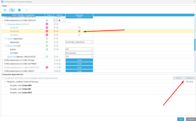

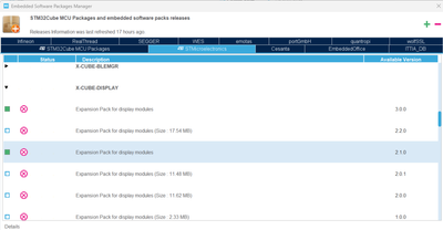

this is my x-cube-display:
I've managed to get it set up in the MCU by clicking the resolve button shown by the red arrow. When clicked, it checked the display, the part that I cannot toggle.

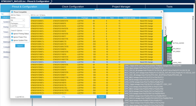

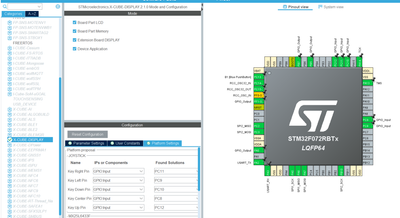

Note: I setup the GPIO by seeing the correct pins in the template of the STM32G071RB with the display, (don't know if it matters to something), by going to "list pinout compatible MCUs":
