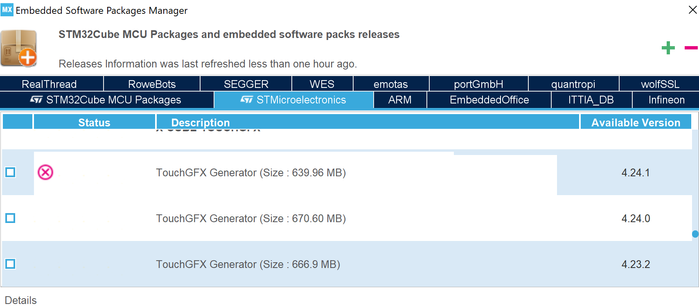

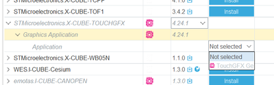

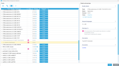

I have all the latest versions.
Every version appears like this and I cannot click on it, it's greyed out.

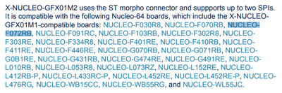

I based my choice on this list (display datasheet). So even if only one picture and a button, it should work, right?
