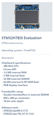

Since the memory questions are unrelated to the topic of this thread, I would recommend creating a new ticket for clarity and visibility.
However, to answer briefly, I would first recommend reviewing the description of the TBS available in TouchGFX Designer. From there, you can see which memories are initialized and used in the TBS. As shown, the SDRAM is e.g. used for the framebuffers:
As a next step, you can review the map file to see what goes where.
