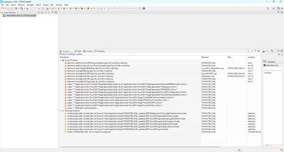

2026-04-26 5:39 AM
Hi Johan,
I have imported your project in My Cube IDE setup. But while build it giving me errors.
Regards,
Tejas Patel
2026-04-27 1:37 AM
Thank you for trying it out!
It looks like you may not have generated code in TouchGFX Designer first. Could you please try that? If you already have, please generate the code again.
When building the project, the process should be:
1. Open the .touchgfx file in TouchGFX Designer.
2. Create a GUI.
3. Generate code in TouchGFX Designer.
4. Open the project in STM32CubeIDE.
5. Build the project in STM32CubeIDE.
However, while validating the steps above, I realized that I forgot to update the STM32CubeIDE project file with the GT911 references in the project I previously shared. Because of that, that project also requires generating code in STM32CubeMX. I have attached a new project that does not have this issue.

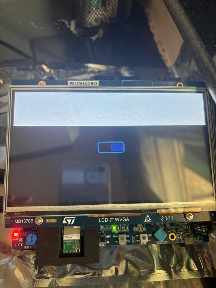

Hi John,
# BSP2 package i have opened, build and flash from touch GFX. GUI is coming on LCD screen and i have tested on touch button it was working.
# If i open it on CUBE IDE and then build and flash it also working.
# I have attached sanpshot of GUI created.
# Now how to make it work in my own project. Please guide for the same.
Regards,
Tejas Patel
