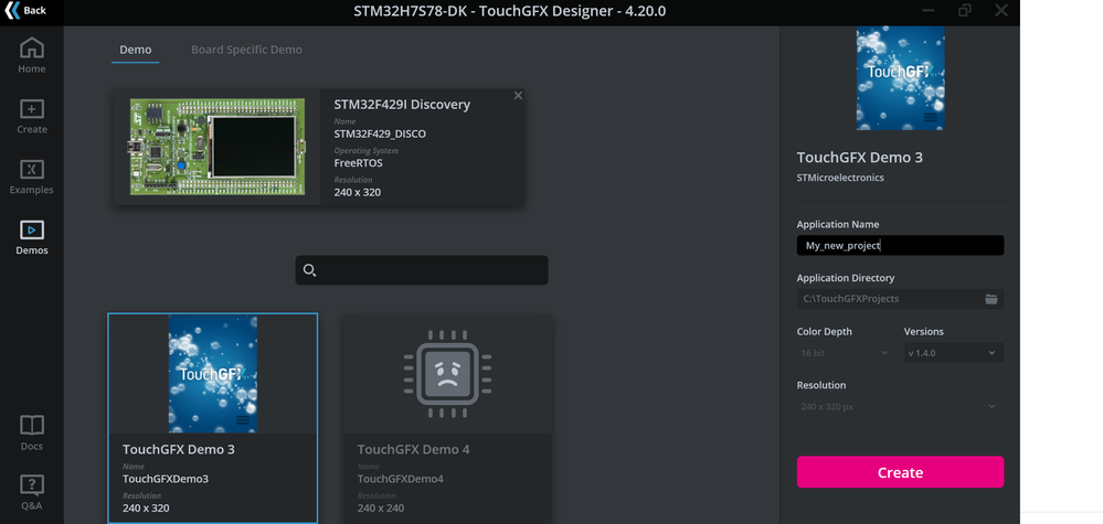

2022-10-11 10:37 PM
Dear Sir,
thanks for your reply, when i go to "Touch GFX Demo 3" and click on the Create icon, the progress bar proceeds upto 33 % and then i get the message of " Download of Touch GFX Demo 3 failed"
This type of problem i had faced earlier ( please refer the first post) where i was not able to download the Dice, please suggest some solution to overcome this issue,

2022-10-11 11:41 PM
2022-10-12 3:22 AM

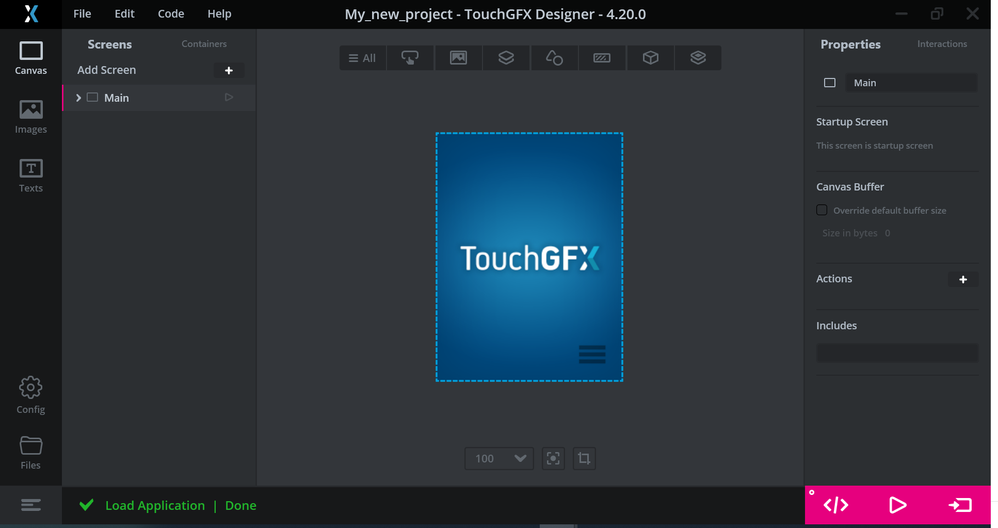

6) i was able to create a simple application in touch GFX designer and test it with simulation
