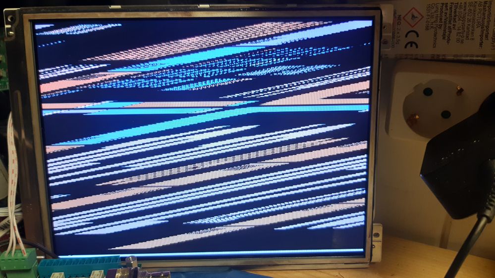

Well, all that mentioned, Thing and problem is. Whit the paramtetres, and several other combinations, shown above, the screen shows up perfectly. I may write text, load images and etcetra. But Sometimes when I add extra code to my program the screen gets skeewed like as if the image was a water-painting someone tried to wipe out, or as if the number of pixel pr. line changed but the MCU still think it is 640 so that the next line has an offseth to previous line. You are able to see that it tries to show the correct image but it gets corrupted
The code added does not need to have anything to do with display functionality, for example I added a few variables and the problem arised. When I removed the code, the display was OK again.

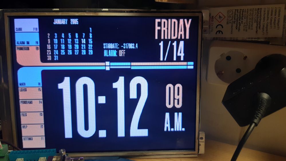

2020-10-24 11:04 AM
There are no error interrupts
Here is the images showing corrupted and OK image
The only different is that the array size mentioned is 24 and not 25 for OK immage. Memory usage is 68%
EDIT:
Looking at the corrupted image you see that it is the same image as for the ok display. However, i noticed now that the 4 last lines are not part of the image. I guess this possibly indicates sync issue for when display expects first data and when the MCU transmits it.
You will see a similar behaviour if one deliberately program the frame start and stop addresses for layer 1 with wrong values (Either horizontal or line or both in register L1_WHPCR and L1_WVPCR), then you will also see this skew. But in the tests above these remains unchanged and should not be affected by the introduced code, and the clock/timing setup for LTDC is as mentioned earlier also unchanged.
I wonder if it could be sync issues with the enable signal but struggles to see how the code i insert (declaing the array) possible could affect this in any ways.
